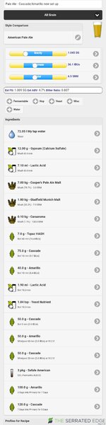

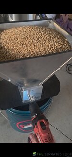

Finally got the rig heating on the weekend.... been a good few years with house child and wife and only yhe 2nd time I've been able to run this whole rig since setting it up.
Double batch pale ale.
66° Sac rest.
Overshot my estimated OG of 1.045 and got 1.049, but was 2L under target volume of 46L
78% brewhouse efficiency, got some tweaks to make in the kettle calculations to get it more accurate.
One of my pressure fermentors got damages in thr shed so had to bosh out the old Coopers FV.
66° Sac rest.

In my defence, this set up has been a been a culmitive progression of builds from about 2016-17... all starting from the small 20L pot on the lower shelf that I first started brewing with lol. I dare say I've never spent more than $200 in a single purchase at a time when i had that cash spare, each just adding something here or there, or getting something for free/ cheap to add to it.
66° Sac rest.

More pipes and connectors and connections and taps and hoses than between the tanks at a winery. You've got it sorted
@Dotts started from scratch with grains, rather than just opening a can of goop & chucking some godawfully generic yeast at it. That requres knowledge, experience, specific equipment & an understanding of first principles.
