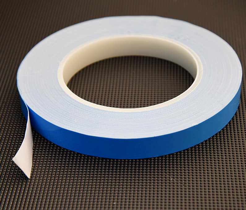

Any thoughts on if I should apply thermal paste between the PCB's and heatsink? Kingrbrite don't do this by standard. Unsure if it is necessary - but seems like a good idea. I'll be running these at bellow their rated max - Kingbrite advise running these boards at 60w, max 70w, but I'll be at 50w.
Haven't bothered on the other strips I have bought from them before, but seen it mentioned elsewhere with regards to DIY builds and peoples opinion of QAQC of manufacturers etc. Cheers
It won't hurt, I'd use thermal tape instead though, less mess 👍🏻
All sorts of sizes
Don't use the past it runs when it heats up. Use that tape Goonie posted. I use it on my builds and don't even use screws.
ED-209
775
It runs? Damn yeah ok that's not good. I've never seen that when using it on CPU's etc - Arctic Silver stuff. But that's a fairly small amount and probably not at such temp... I was kinda preferring to do it that way as I can just grab it locally from a PC store.
Maybe I can find the thermal tape locally also... but yeah I can order from cutter also
Should have mentioned Jaycar sells thermal tape. They also sell big tubs of cpu paste.
I used the stuff from jaycar on a large quantum type board and it ran out and dripped on my plants. I may have used the wrong shit it was white in colour
ED-209
775
Oh ok - weird. Sounds like it might have been some other sort of thermal paste.
Arctic Silver is fairly viscous - once it's been heated it normally gets firm and bonds (not permanent) between the heat source and sink - ie CPU and cooler.
I found the thermal tape at Altronics and another place nearby - but even getting some 100mm strips shipped wasn't too bad. Can cut them down.
I'll have a think about it
