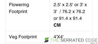

Because their profits would be less if they only sold you one light. 😅300 true watts is adequate for flowering a 3x 3 space. Depending on shape/profile of light( I'm too lazy to google it, I'm on my fifth joint for today), some edges/corners may not get enough light. But that many watts in that space should be capable of yielding close to a pound.

Look at the footprint ..some are rectangle ,others square.
Make sure the footprint is for flower not just veg as the veg footprint is often larger

Well for starters it’s not equivalent to a 600w hps. 😂 second it’ll do it but only just and as a single light you’ll loose intensity around the edges which probably won’t be an issue with 1 plant

The footprint is a tad confusing with the 300l rspec, it has 2 measurements for flower.. 2.5 or 3 foot? Veg is plenty at 4ft 20220716_184348.jpg

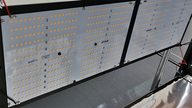

How handy are you everyone raving about lm301b diodes (HLG uses) but the cree 2835 is more efficient and better spectrum (98cri as opposed to 90 and 228 lm per watt to 220)cutter electronics has diy kits for around 620 for the 3500k version which is all round veg and bloom that use cree and will be everything as good if not better than HLG just need to assemble. the the Hlg in the same price range half the diodes 576 as opposed to 808 and there not as good of a diode 220lpw as apposed to228 and you can use different drivers and drive them up to 415 watt which will cover a 3×3 nicely at 415w the par map shows 1200 and 1000 par on the edge of 3×2 so projected out 6 inches either side to make a 3×3 the par will still be very high
Thanks, I'll check em out
They got heaps different diy set ups I'm building a strip build in a couple weeks should smoke top dollar bar lights you could also build one of there 4×4 strip kits but tighten the spacing up and build a killer light 3×3 light just need a 3×3alloy sheet to mount them on
