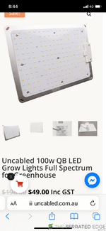

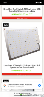

Would this be any good for , seedlings/clones ? It’s a bit on the cheap side ?
Funnily enough I saw that light last night, has a dimmer which is good, for seedlings you want a light with a good amount of blue (a mix of 3000k and 5000k would be ideal), more red = more stretch
Just looked through the specs, mix of 3000k and 6500k with a few 660nm deep reds. Looks pretty good to me, driver isn't listed though so it's probably a cheap one but should be decent enough though
