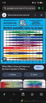

Neutral isn't a requirement, that's just what I need due to a more acidic potting mix. My medium is 5 flat and can tent to high 4s so if I water at neutral pH the medium stays in its zone.
As long as the potting mix is between low 5s to mid 6s your in the sweet spot, you can just ignore that now. Just keep the Input around 5.8-6.6 and you should be fine. I only do the slurry just to make sure it's not overly acidic or alkaline once at the start as sometimes you'll get an acidic or alkaline mix.
Adding some feed will drop the pH a bit as well. See our tap water is around pH 8-8.5 here so i have to cut it with rain water to get it neutral and it'll just buffer to the mediums pH which is around 5.3-5.8. It doesn't have to be neutral. Thats just what I need as my medium is far more acidic than yours at around 5 flat and my tap water is Hella alkaline.
This will help you understand the window a bit better...some nutrients like acidic environments, some like neutral to alkaline. A bit of swing from 5.5-7 here and there is fine so it's not one hard number, plus every plant is different.
From general experience I've been slightly alkaline a few times with no real issues but he most common indicator of pH issues is interveinal chlorosis and rust spots from low pH which will cause Ca and mg uptake issues.
If I drop under 5-5.5 too often I'll get calcium/magnesium issues in potting mix, but if i swing up to neutral I don't see any real indicators of pH uptake. Issues with alkalinity usually show as micronutrient deficiencies and general yellowing once you get about pH 7.7-8.
