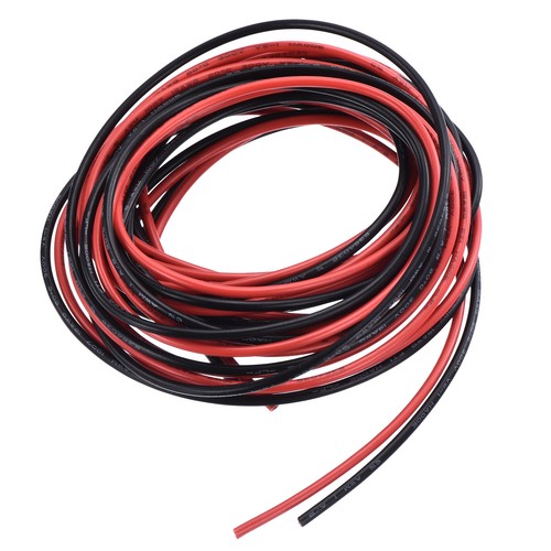

https://www.altronics.com.au/p/w057...MI7K6c2pveigMVfBqDAx2X5yTdEAQYAyABEgIBevD_BwE (2-5 meters)

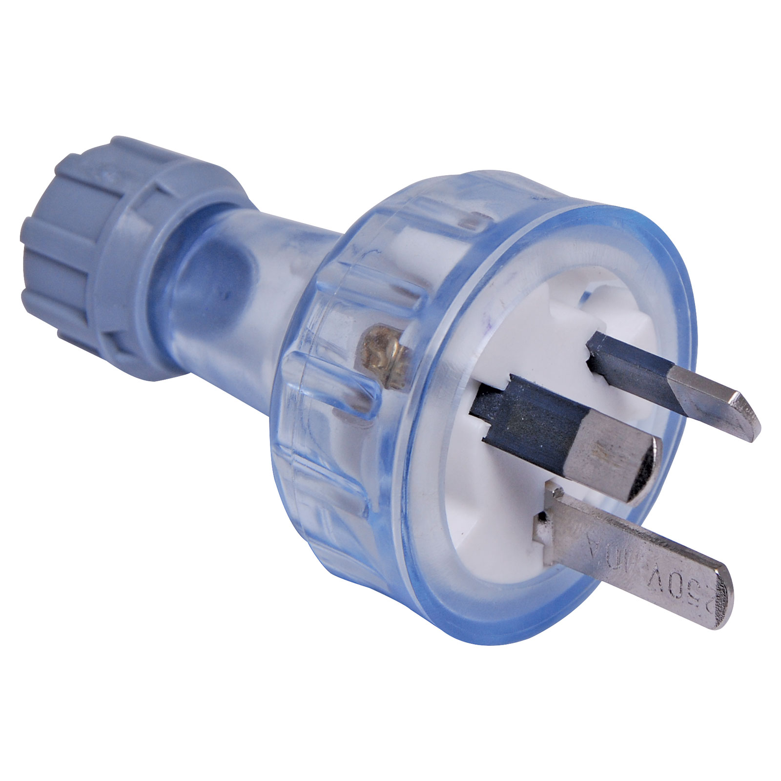

https://www.mjselectricalsupplies.c...MI7tiKgpveigMVz9dMAh3TBhxPEAQYBSABEgLqvvD_BwE ×12 or so

= Approx $700
That's just a rough build without heatsinks.. if you plan on running heatsinks be prepared to cough up.
