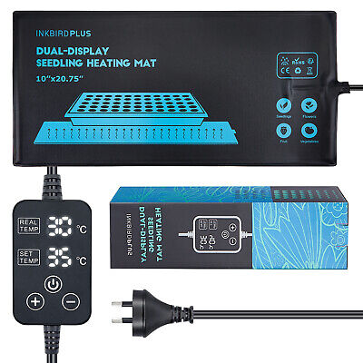

Another member mentioned a sale on these recently, so purchased one to help get some seedlings sprouted in the cooler weather.
Arrived promptly and for a cheap chinese made product is actually packaged well and looks to be reasonably well assembled.
plugged in and does what it says, heated up to desired temp pretty quickly and the heat feels consistent over the mat.
Instructions actually make sense.
I plan on putting a little domed seedling tray on top with some rockwool cubes and seeds straight in.
Anyone got any ideas what temp to put it at? I assume the plastic seedling tray will absorb some? maybe?

I'd do a test to see how accurate it is and how much heat loss you get through the plastic and cubes. Set it all up at say 21° and check on your air and cube temps.
+1 test it first, with another thermometer, after running it for an hour or so. If the sensor is faulty and it climbs over 30% it can fry seedlings. Anything from 20 to 25c will work.

Yeah I got one to, fits in bottom drawer perfectly, it tells me already 27 degrees so I set it for 25 to see if it would reduce but no chicken dinner

finally got around to running a little test on this.
Setup is as shown below.
Heat mat set to 26 degrees.
Humidity dome closed.
Single rockwool cube (wet).
The rockwool was wet under a tap and set in the humidity dome, switched on inkbird.
Ambient temp was just taken off a thermometer outside, but no heating on so the temperature change inside should be similar.
The mat surface temp was measured on the mat with a laser temp meter in the same place each time.
The rockwool cube was measured at the top close to centre by opening the small hole on top of the dome.
This morning I also opened the dome and turned the rockwool cube over. the base of the cube measured 24.6 degrees.
The green plastic base of the tray underneath, measured 26.6 degrees.
Seems I lose about 3 degrees from heat mat to the top of the rockwool cube. Also appears it only took about 45 minutes to warm the rockwool cube to full potential. (5:30pm-6:15pm).
I always have great success germinating seeds under my fridge or near something quite warm, so my aim is the have the rockwool temp at round 28 degrees, meaning I will set the inkbird to 31. Feedback welcome before I cook some seeds ;)
TimeAmbientMat surfacetop of cube
5:30pm182720.2
5:45pm1826.522
6:00pm1827.122.9
6:15pm1726.523.5
6:30pm1726.723.7
6:45pm1626.623.8
7:00pm162724.1
8:00pm142724
9:30pm1226.723.6
8:00am1426.223.2

Had it running at 31 degrees since this post this morning.
The top of the cube is at 27 degrees.
That will do. Ill pop some seeds straight into rockwool in there tomorrow and see how they go.
