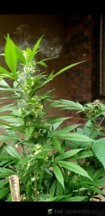

Yeah but what’s the recipe on it. There’s a few getting around. A group of mates and I recently did an experiment on sts strengths and application times recently on a few strains that didn’t want to drop pollen last few tries. Application times don’t matter as much we found but solution strength does.
Visible pollen coming off the plant, no need to harvest balls and pollinate female if they’re in the same area.
Here’s what I got from having my reverse plant in with my females. Haves shucked more than a few buds yet but I’m already up to a few hundred. 7AF09234-FA7F-4ED5-9C24-C1713F5C449E.jpeg84656147-AC91-47EE-8CB8-51EE730A953E.jpeg7F6CBD30-6232-412B-BFE7-DF638EE72C06.jpeg4C6B9E3A-0D12-45E3-AB31-9F32BDB4D06D.jpeg
This is our results.View attachment 23772
Here’s what I got from having my reverse plant in with my females. Haves shucked more than a few buds yet but I’m already up to a few hundred. View attachment 23773View attachment 23774View attachment 23775View attachment 23776
