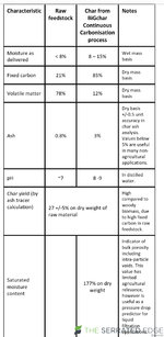

Sweet. Sounds like you have a good system going. I have a really good paper on biochar here if you're interested: https://drive.google.com/file/d/1tTo_b6a0eXvYfu_2oV0kBQeZ3GdGufVp/view?usp=drivesdk
