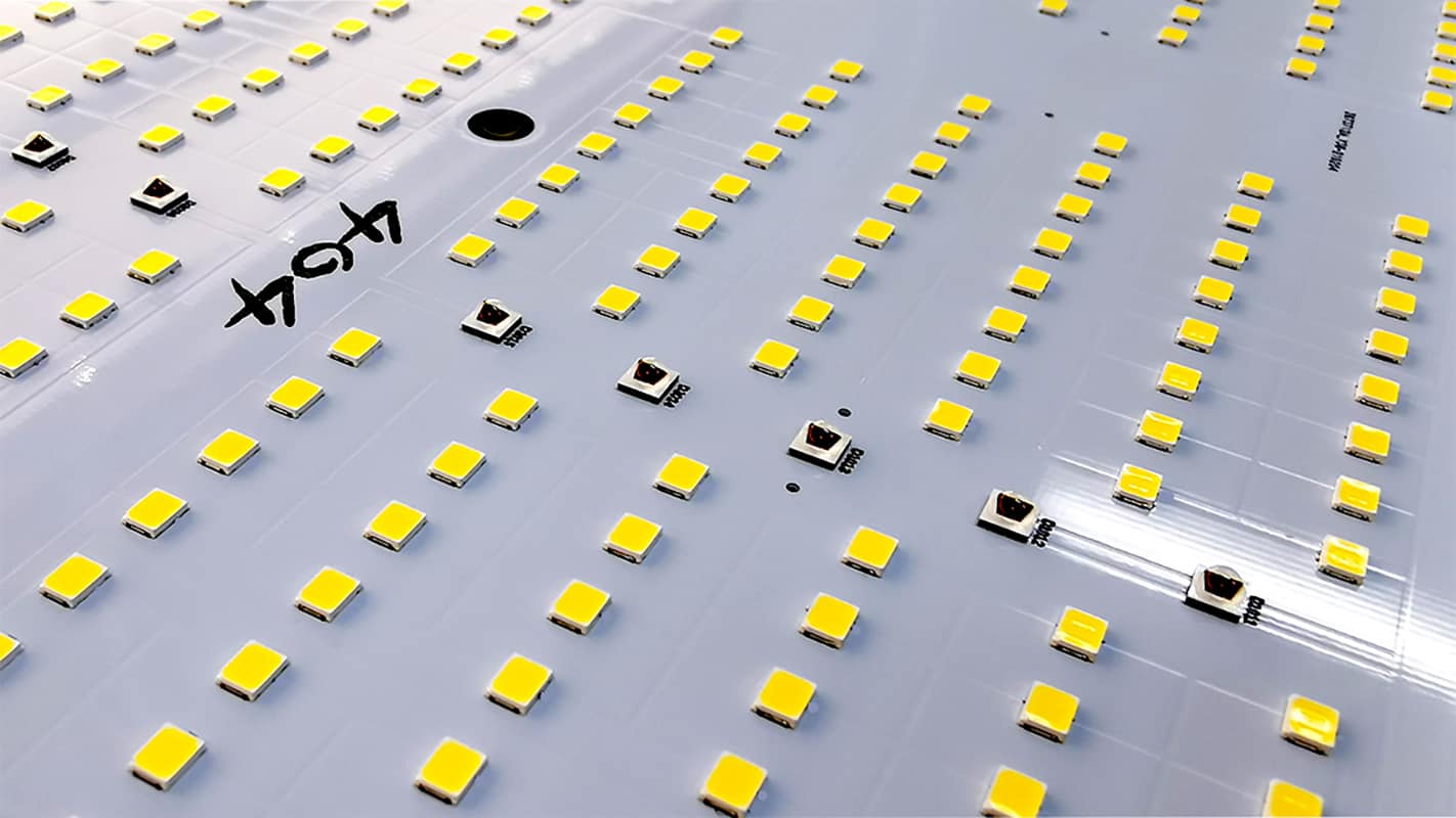

Got the cutter boards yesterday. Also decided to cut the heatsink in half and extend the light by 200mm to get a better spread the thing kicks arse wacked it in the flower tent I stead

Liking the build, nicely done
Cheers

Thanks mate I built another Frankenstein light yesterday with 2 of your 404's to I was previously running a CXB3590 setup I got from you a couple years back but had an accident in the shed and 3 don't work so had to go back to the old tech untill I stumbled across your 404 boards I can run on my 36v drivers I have an abundance of
