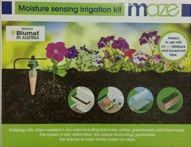

I bought a pack of blumats, but I think I got the wrong ones. These look like they're for pot-plants etc. (not adjustable top and can't be daisy-chained).
Anyone used this type? One per pot?
Or maybe I should just use these for pot plants and get the one with the adjustable dripper etc.

I use those classic ones which I make shift connected to a 25lt water drum out side my tent. Works ok but the dripper ones look better. They sell the dripper ones on catch.com under brand name Maze, cheapest I seen online. I think Bunnings stop stocking them.

I used that type of Bluemat for a couple grows. There are wo major differences between those (Classic) and the kind many people like us are using (Tropf). #1 No daisy chaining, each "carrot's" feed line must be in the reservoir. #2 They don't seem to have a valve for controlling the water, just a continuous slow release of water. I put three in each 25L soil pot and ran all the feed lines back to reservoir. For reservoirs I used plastic jerry cans from bunnings and each plant had it's own. They worked well, including a 2.5wk trip out of town and no babysitter. You can control the water release somewhat by changing the rez's elevation relative to the carrot (higher up = faster; close to even height = slow; lower than the carrot = nothing, because you're working up hill).

Thanks mate - oh that's awesome to know they're still usable. Jerry cans is a fantastic idea for resovoir.
Awesome - might check out those ones. Thanks Dogfish and everyone else too for input.
