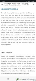

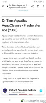

I was looking into ways of cleaning up my tap water so I can use things like Dr Greenthumb myco and worm castings and to get the chlorine and chloramines(sorry if I'm wrong) out of my tap water. I was looking at Dr Greenthumbs site and they have a filter that attaches to the hose and I did a bit of google searching as ya do and I came across this stuff. I messaged them and they say it's safe for plants, it's for aquariums primarily but has anyone got any info. I'm not to sciencey to know but it's safe for fish..thanks in advance hey..

Prime is great for your aquarium, but way too pricey and overkill for what you want for your plants. Those filters that DG sells are more than enough, and they are just GAC (granulated activated carbon) filters and can be bought online for half the price.
