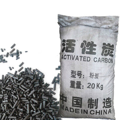

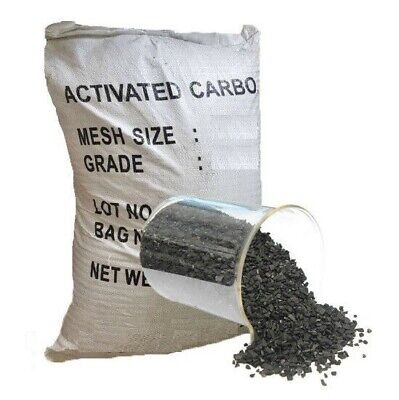

You can buy 20kg bags of activated charcoal on eBay for around $120. Haven't done it myself but from what I've read it can be a pain getting them back together, but persistence should pay off.
