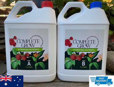

Not sure how mate like mentioned no good at tuning in nutrient, I can tune cars! This is whats in my tank.I'd drop the feed ec down to 700-800ppm / 1.6 ec
1335ppm is 2.4 ec which is pretty high and you're wasting nutes by the look of the runoff
Are you sure you read 1335ppm and not 1.3 EC?Not sure how mate like mentioned no good at tuning in nutrient, I can tune cars! This is whats in my tank.
oh 2ml to 20 L nutes![]()
Hydroponic Nutrients Hydroponic Plant Grow and Bloom A & B set indoor / outdoor | eBay
Complete Grow hydroponic nutrients is suited for all hydroponic systems. SO YOU GET THE BEST NUTRIENTS YOUR PLANT NEEDS. coco coir, rockwool, soil and potted plants.www.ebay.com.au

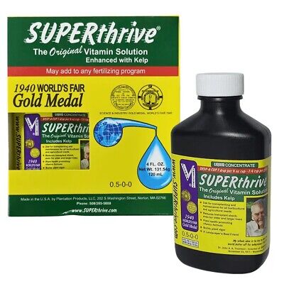

Superthrive Vitamin Solution For Plants 120mL Super Thrive Growth Enhancer Plant | eBay
Pictures are for general viewing and may not always resemble or be inclusive of the item received.SUPERTHRIVE VITAMIN SOLUTION 120mL SUPERthrive® is a highly concentrated non-toxic vitamin solution invigorating all variety of greenery for home gardeners and professionals alike. It is equally...www.ebay.com.au
and this at mid bud stage but only 1.5g to 20 L of nutes

you just have to use equal parts A and B,
Try 3ml of each per litre of water
