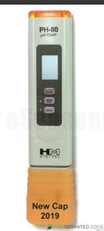

What PH pen is everyone using. Ive got a HM and I test it weekly in ph 7 and ph 4 calibration solution and it's always out. The fucker was reading 9 and 5.4 in each solution so not only is it out it's not constantly out. It's reading 2 higher on 7 and 1.4 on 4 it's in the bin. Are blue lab the shit or another brand TIAScreenshot_20230304-102002_Chrome.jpg

I had the same problem with mine don’t ever let em dry out is the trick the hm doesn’t come with storage solution so you have to get some I changed to blue lab they are the shit if cleaned and stored correctly barely if ever 0.1 away from calibration solution it’s been 1.5yrs since change n never missed a beat only calibrate monthly now👍
I had the same HM pH pen and it worked great for awhile, but then it started needing constant checking/calibration :(
Couldn't trust it, so I bought myself a Bluelab and have never looked back. So far everytime I've checked it it's been spot on (y)
What PH pen is everyone using. Ive got a HM and I test it weekly in ph 7 and ph 4 calibration solution and it's always out. The fucker was reading 9 and 5.4 in each solution so not only is it out it's not constantly out. It's reading 2 higher on 7 and 1.4 on 4 it's in the bin. Are blue lab the shit or another brand TIAView attachment 32136
Yeah get a blue lab they the best by miles!!
I let mine got out of cal for a month and tested it and it was still perfectly accurate!!

Doesn't matter what brand, if you don't store it storage solution it'll be fucked before long. A 250mm bottle cost about $12 and will last 12 months.
I've had a HM ph80 for about 14 months. Fill the cap halfway with storage solution. Every time I use it, I drop 1-2ml extra in, Want to see a a bit squeeze out everytime you cap it.
Rinsing in fresh water and a wipe/blow dry before capping. Never shake the water from them.
I only use it once or twice a week now. Get to know the drill. Calibrated it probably 4-5 times and its always within 0.1.
