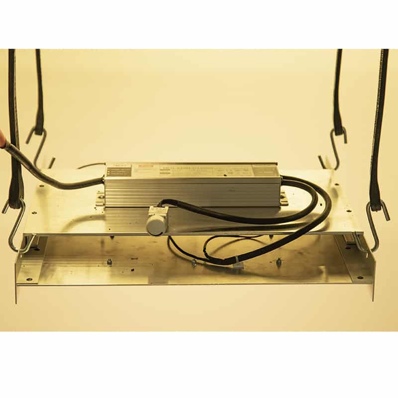

There's no soldering now mate they all use molex solderless connections. there spring loaded clips already soldered on for you and best part is if a board or strip dies you just push the tab and pull the wire out.and swap it out . You just have to screw them together. You can also choose what colour you want like full spectrum of veg or just flower. The kit below is prob the easiest you get 4 of what's pictured. Or you can step it up to the light bar style.
I use these in 2700k for flowering. Theve got 404 diodes instead of 288 and are bright as fuck. I run 6 boards(same amount as the scorpion) except I can turn it up to 960 watt opposed to 700. It can cover a 6×4. There set up in pairs so you can run 320 watt or 960. I could build 6 of these for the price of a scorpion you just have to source some 190mm×6mm flat bar to use as heat sinks

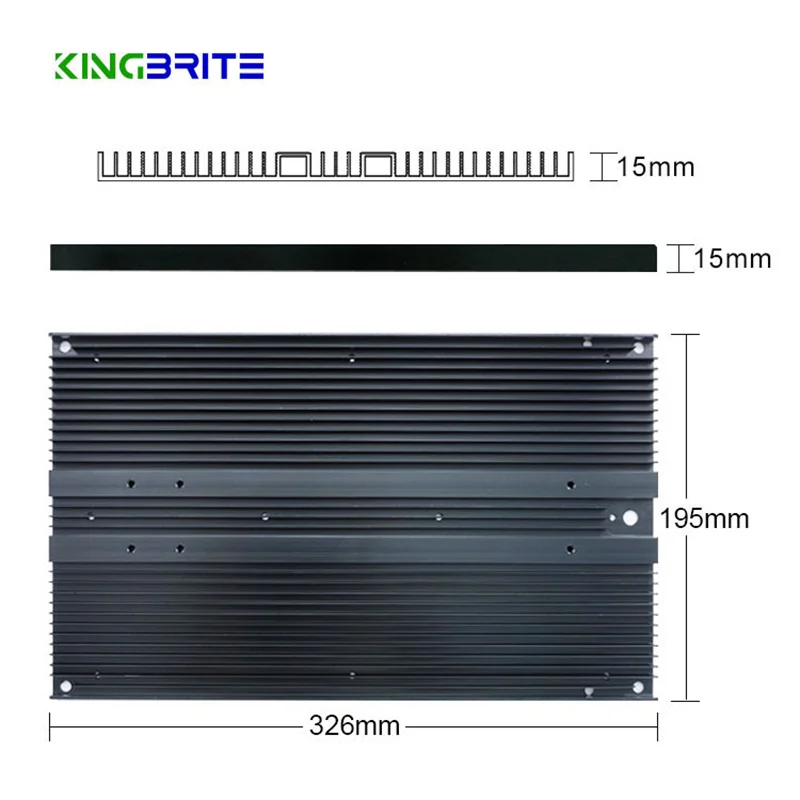

Around 12 months. I started by upgrading some chines HLG imitation lights that the boards were toast. I got them off a couple mates they were headed for the bin. Then picked up the bar light cheap off a bloke that couldn't get it going that has 16 strips configured into 8 bars of 2 strips per bar that does a 4×4 nicely at about 500watt but can be turned up to 600. You need aluminium to dissipate the heat. Your using the aluminium as heat sinks. The strip lights you can use 25 mm C channel at about 2mm but the boards need 6mm plate or a heatsink but don't get the cutter sinks he charges a fortune I got 2 from Aliexpress for same price as one delivered.they all use double sided heat sink tape to stick them on the alloy so doesn't matter if the holes are different. The Chinese shit doesn't use any thermal paste or tape. just screwd to the sink and I recon that's half the reason they don't last. here is a link to the heat sink but a lenght of 190× 6mm plate was about $220 for 4m and you can get 13 heatsinks from that. They need to be 190×300 then just use alloy angle to join them
Here some picks of the light made with the 6mm plate. The drivers i got off some high bay led I got for 20 bucks on marketplace the whole light cost Screenshot_20230915-071412_Chrome.jpgScreenshot_20230915-071316_Chrome.jpgaround $180 if you study up and learn about drivers you can Frankenstein quality performing lights fo nix out of different components these are the 404 boards
