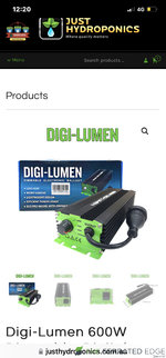

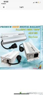

I want to try HPS... cus Ive only used the SF3000 LED.
Would 600 be overkill in a 1m x 1m tent
Or should I go 400 ?
Humidity is not an issue cus I have a kickass dehum...
elsooto
6
Up to you kneeko, you could always get a 600 that has the setting to run at 400 if 600 became an issue.I use a 400 in the same size tent and it does the job. I normally only run 1 plant at a time tho so it's a decent veg period. Think my pb was 14.5 oz off the 1 plant, and could better that I reckon
Yep, like soot mentioned, a variable setting digital ballast would be a good fit..
Lumatek 600W digital ballast
That way you got the option of 250w, 400w, 600w and 660w light. A straight 600w in a 1m x 1m space might be a bit much in the heat dept, if you don't have a cooltube extracting shitloads of air.

Im liking the looks of the Lumatek gear... Trying a cheap $200 HPS setup has grown to over $500 now.. 😆
Thats the problem when ya get bitten and start shoppin....
