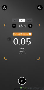

That's really interesting! What kind of meter do you need to measure dli?
I just go the cheap way. Using a lux Meter and taking multiple measurements a few inches below cola tips (where most leaves are), I can multiply the results by 0.016 to get PAR (within a few percent as tested with an apogee) and run it through a DLI calculator. I use the one on waveform lightings site. I try make sure every head is getting at least a DLI of 30, and that usually means the highest most central cola is at about 45.
That's around 650umol/s or 40kish lux on the outer colas and 1000umol/s or 60k lux in the hotspot at 12.5 hours.
What is this DLI you speak of??
Daily light intake I'll guess?
How is it measured?
I should probably look it up! 🤣
