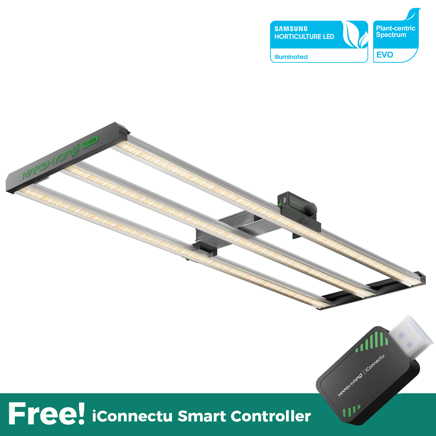

Lights -
Mars for a 2×4
[Extra 5% code:MHFC] Mars Hydro FC4000-EVO 320W Dimmable Samsung LM301H EVO LED Grow Lights
Mars Hydro FC4000-EVO LED Samsung LM301H to grow lights, deliver 320W uniform and strong lighting to promise rewarding harvest for growers.
marshydroau.com

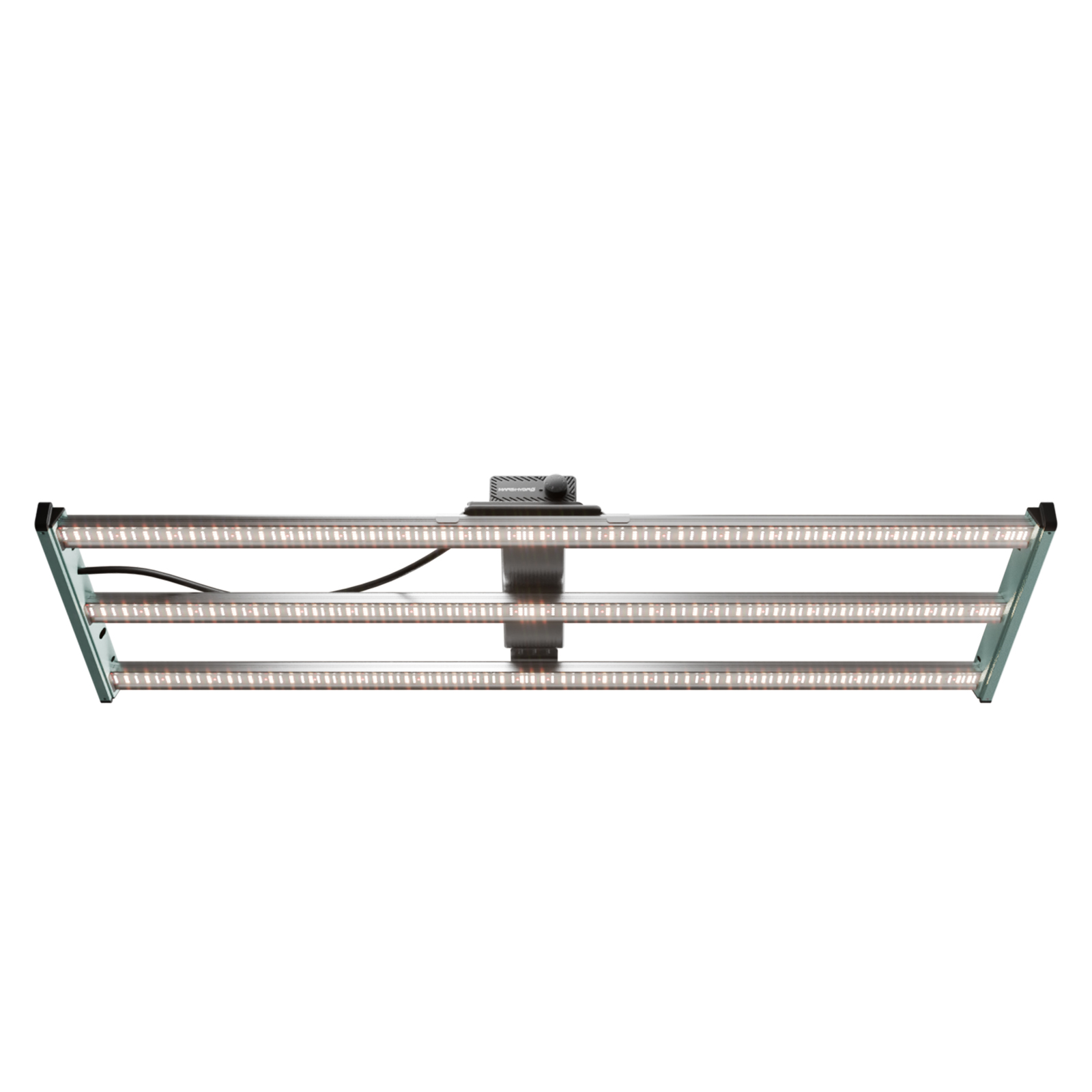

Digilumen for a 4×4
Digi-Lumen 720w Extreme LED Grow Light - High Output Full Spectrum
The DIGI-LUMEN 720 W Extreme LED delivers serious power and efficiency for commercial growers, greenhouse operators and serious hobbyists who want top-tier light performance without ballooning energy costs. Built with a fully integrated 720 W driver, this LED outperforms traditional HID lighting...
www.quickbloomlights.com.au
Personally I like the spectrum of mars better, but the digilumen is too much of a good price to pass up for a 4×4 space. Its well worth buying bar style led lights, by far the best when it comes to spread, being more even unlike quantum boards which have hotspots.
