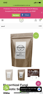

I use this one from nourishmeorganics.co.au when transplanting. Bit cheaper and goes a long way
